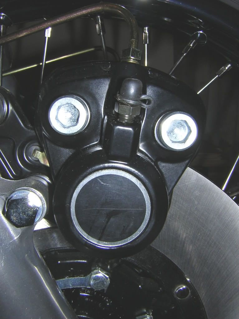

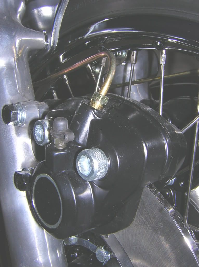

As an alternative to painting,I had my 2 calipers blasted to remove paint,vapour blasted on the internal side and then satin powder coated(very thin coat) all done by Griffs reality M/Cs in Bristol.I have painted them in the past and they chip and are also attacked by the brake fluid when bleeding.I will post a couple of pics of my restored calipers later then you can make your own mind up.
