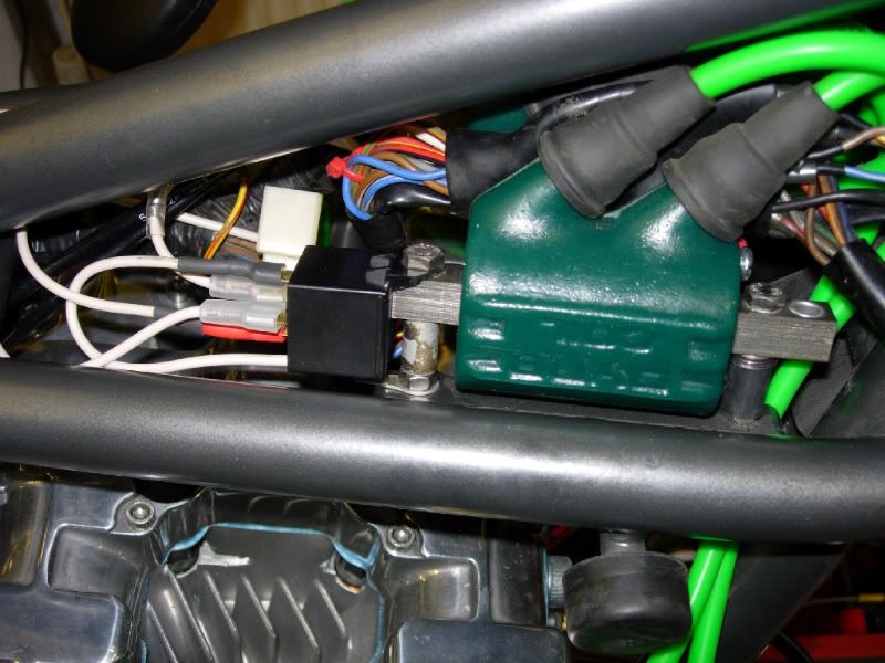

Kenny, here is a pic of my Dyna's fitted to my 78 Z1000. No problem with wire's hitting frame. I can only think yours could be mounted differently, or some sort of frame bracing is causing the problem.
Also note the bit of heatshrink around the mounting post to stop short's.
The coils themselves need to be earthed, Mikey had a problem earlier this year, where the powdercoating on the frame stopped the coils earthing properly & he was getting shocks left right & centre
I believe he scraped some of the coating off to resolve the problem.
One coil should fire 1&4, the other 2&3...... Good luck

cheers bear,thats where i had em mounted but didnt look as good as that!the ht's hit really hard against the frame,i never earthed them when they were under the tank,prob the reason i kept getting zapped,i earthed them now and ye,had the same prob getting an earth cause of the powder coating,but i've scraped a bit of,
