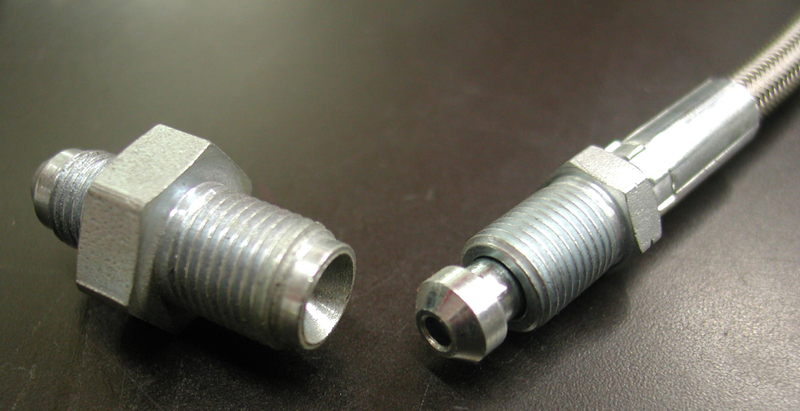

The picture should show the different ends .
Concave is a funnel towards the pipe
convex is a bulge on the end of the pipe.
http://www.bikernet.com/docs/stories/10717/EPSN2958.jpg
If you have a flat surface , on the caliper, making a brake pipe with the convex end may seal.
Most garages can make a test pipe up to try this.
The problem is that most garages use copper or cunifer not steel .
If you want a couple of pipes made up in copper let me know and I can make a couple up. Just give me the overall length.

Thanks for the offer. I have purchased the steel pipes from ZPower and are exactly the same as the picture in the previous post. You will see the bottom of the pipe is convex but the base of to hole is also convex leaving nothing for the pipe to pinch up on.
I cant understand why it is like this but it is.
Ill keep digging away.
