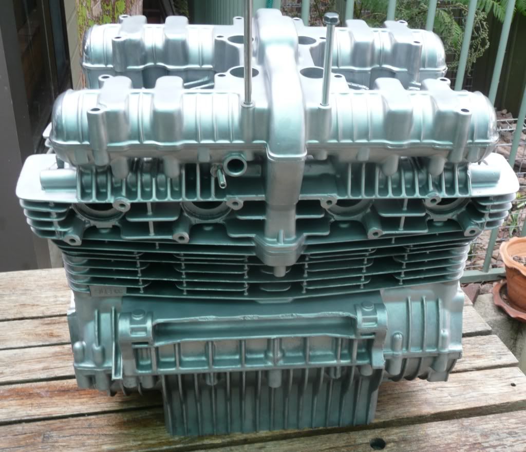

I,m not sure but am wondering if they have had a bath in a caustic type degreaser which would leave them grey and could also leave the whitish deposits (chemical salts) on them.

kev edwards wrote:I,m not sure but am wondering if they have had a bath in a caustic type degreaser which would leave them grey and could also leave the whitish deposits (chemical salts) on them.
You may be on to something there Kev. A year or so ago I left an engine sprocket cover overnight in a bucket of degreaser thinking it would save me some time. The next morning the case had turned a dark grey, almost like it had been chemically burnt. I thought it would have to be scrapped but Mikey managed to polish it back to a mirror finish.

#18 PostAuthor: mikey » Sun Jan 01, 2012 6:50 pm
Yes that right simon forgot about that but it was a dark greyish color wasnt it
and badly scarred to as i remember by the caustic effect of the solution

DDZ900 wrote:In my oppinion the media that they have used is filthy, we filter it all the time & you need shades on when the jobs finished ! to do this aqua blasting properly it doesnt just take 5 minutes iv done dozens of "z" motors :wink:
Yea just about to add the above, had experience of such likein many processes Eg Chrome plating can give bad results if the medium is not kept clean, lots of cowboy companies really dont take the time to recycle the media or Chemicals properly, or like our local Chinese they use the same oil over and over and over again and everything tastes the same, blastings no different if the beads have turned to mush with all the old carbon, oil, paint and everything else added the results will be shit,
the lads have also mentioned grit ans sand these open up the pores and cause quicker Oxidation, whereas beads, close the pores and polish and strenghten the material thats why racing components are bead or similar blasted NOT sand,grit or otherwise

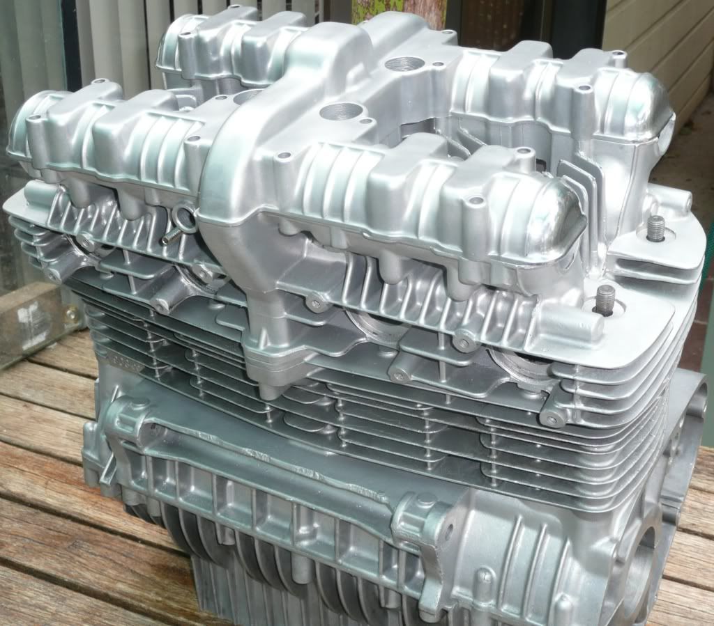

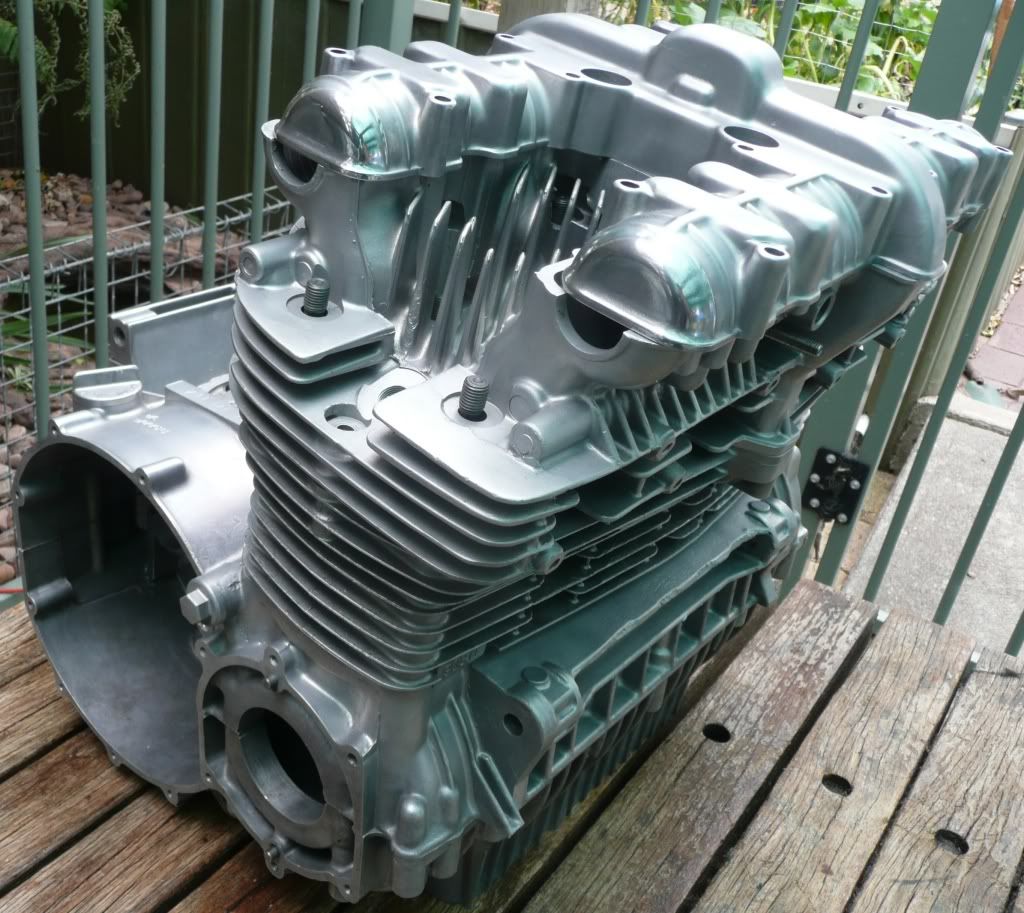

#20 PostAuthor: kennym » Sat Jan 07, 2012 11:19 pm
Thank you everyone for all your suggestions, I believe that it was due to the chemical additive that was being put into the water, it was aquablast ? some salt mix which I think was causing the aluminium to oxidise virtually on contact, It would appear that the operator may have doubled up on the mix anyway I requested that we try again without the additive just the glass beads and clean water, I was allowed to do the blasting myself so completely hands on the results are much more as to what I was expecting thank goodness. I guess you must e dilligent and keep a eye on everything now on with the rebuild must go lap some valves

#21 PostAuthor: Z1B » Sat Jan 07, 2012 11:53 pm
Did you get it blasted as it is shown or are the parts sitting together to show us the finished product ??? this is quite important as those beads need cleaned out of the cyl head threads etc if absolutly everything was not blanked off, you will need to put grease on a M6 tap and run it in to each threaded hole to remove ALL beads, and absolutly blow and wash out every oil passage through the head, if the blaster is not absolutly switched on with engine parts you will end up with a wrecked engine, I am only playing the devils advocate here, but you mentioned dilligence so thats something to kick off with. :) let us know what blanking was carried out.

#22 PostAuthor: Z1B » Sun Jan 08, 2012 12:06 am
Just had a quick look at your parts at first, looking back now over them it is fairly obvious that you have sat them together to take the pics, initial concerns were based on years of experience of other folks having done similar and myself having to rebuild the poor bastards Zeds etc hope alls well :)

#23 PostAuthor: kennym » Sun Jan 08, 2012 2:50 am
thanks Z1B you are correct the parts are just sitting there, I have started the task of making sure tht they are 100% clean, bloodey hell I never relised that there were so many bolt / screw holes lol
