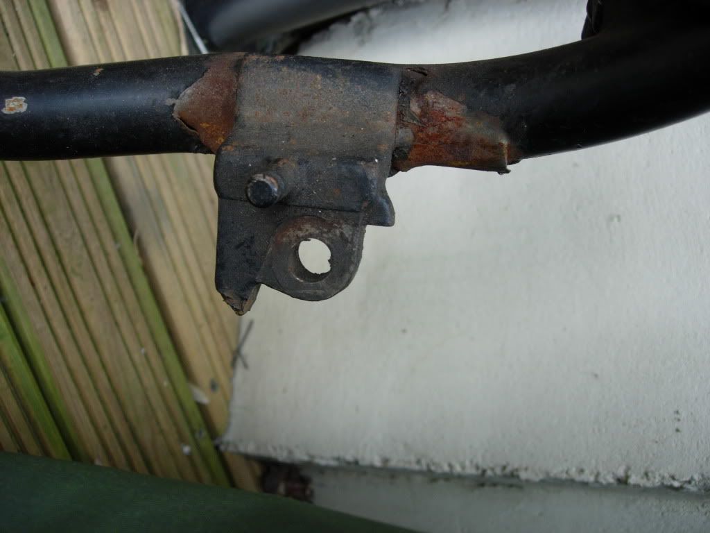

Side stand bracket looks a little wonky rz!

As Al says, that side stand bracket looks a little 'bent up', best to check underneath for rot or damaged welds, it could tear off if left unchecked.......
...... like this;

Hey guys, you had me worried for a moment.
Sidestand bracket is solid, as is the frame. I've owned bike from new and its done bugger all miles. Was stored inside for 17 years, and used in OZ before that so no road salt or months of damp roads to dissolve it. I see what you're saying but it looks no different to me than when I bought it.
