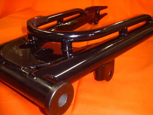

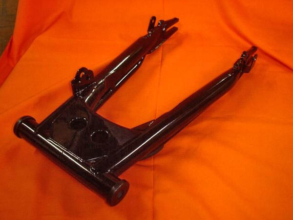

I don't know how to place a pic on the comm but if these links work you can click on them and they "should" take you to a Yahoo auction page with braced swingarms. Perhaps you could cut and paste the pics for future reference because as soon as the auction finishes the link wont work.
http://page14.auctions.yahoo.co.jp/jp/auction/s43537985
http://page15.auctions.yahoo.co.jp/jp/auction/t23386223

Chris. good job on the pictures from e-bay via GBH.

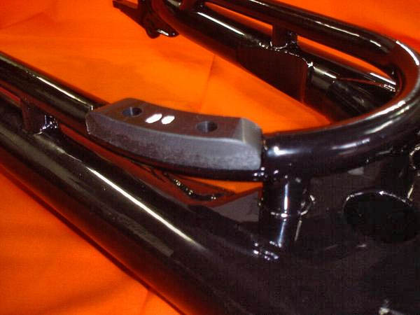

Now, can I ask, with reference to the bottom pic, what is the pad on the chain side leg? Anyone know? The only thing I can think of is a chain rubbing pad. Looks good!
I have seen the standard swing-arm with a 1/4" milled slot down each leg with a 1/4" x 3/4" mild steel bar, intermittently (3" runs) welded, both legs. It was on my Z1B Yoshi, that I sold last year. However, the above (e-bay one) looks better. Of course! the expensive alloy swing-arms available in Japan are really the go, as I've heard they improve the handling tremendously!

Garn1, the nylon things exactly wot you summised, to stop chain damage to swinger!
Does look like a very smart job! I'd have though it'd be cheaper to buy an aftermarket jobbie, rather than employ an engineers services, unless u can do it yerself! :p
