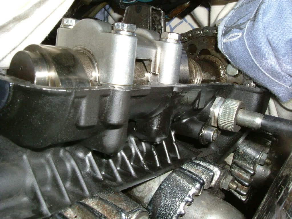

What I propose to do is to make a mould for the outside shape by smearing another lug with vaseline and using JB weld 'putty' to replicate the shape. Once that has set I will remove the cam retaining cap and clinically clean all the area.
never done that so notsure how successfl it will be but I reckon you will push the vaseline outof theway when slaaping on the JB.
maybe some like cling film or wax release agent, the stuff used to cover moulds for grp fabrication would work better. guess it will involve some trial and error.

Well, I made a mould out of JB Weld 'stick', lined it with cling flim and held it in place with a compression spring. I then gently heated the JB Weld 'resin' and coaxed it down the entrance hole in order to fill the void.
It seems to have gone ok but time will tell in the morning when I remove the mould :??
Hopefully it'll be a simple case of drilling, tapping and inserting a helicoil to complete the job :|

It worked !! :P :P Popped a helicoil in afterwards, clamped down fine and the lug looks almost as good as the others.
Well chuffed with the result :arrow:
Kawasaki H2C 750, ZRX1100R, H**** VF1000RG Rothmans, H**** VF500F2F, Suzuki GSXR750F Slabbie

looks quite successful!!
hopefully it'll survive the real test once you get the engine up to temperature.
