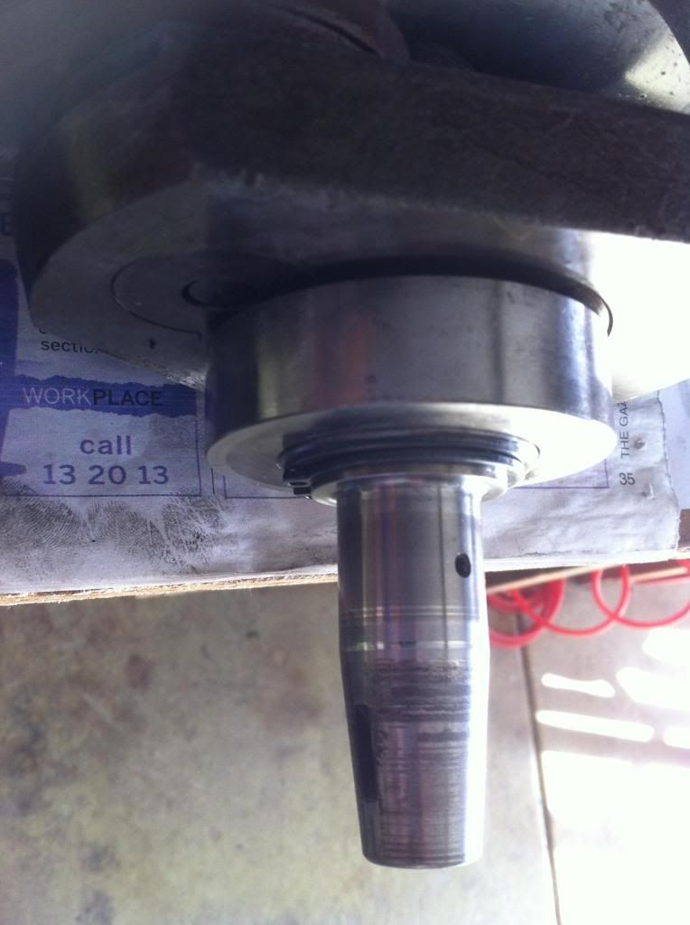

Hi All,Crankshaft removed to replace camchain / guides etc
Some wear here on taper for rotor.....Key is in good nick,so the rotor hasnt spun,key sheared etc.
Anyone been down this rocky road.....
Posts: 2319
#2 PostAuthor: zed1015 » Sun Apr 20, 2014 10:34 am
Looks like the rotor has spun in the past.
Doesn't look too bad though.
A light lapping of the rotor on the taper with fine grinding paste will neaten it up and provide a closer fit.
