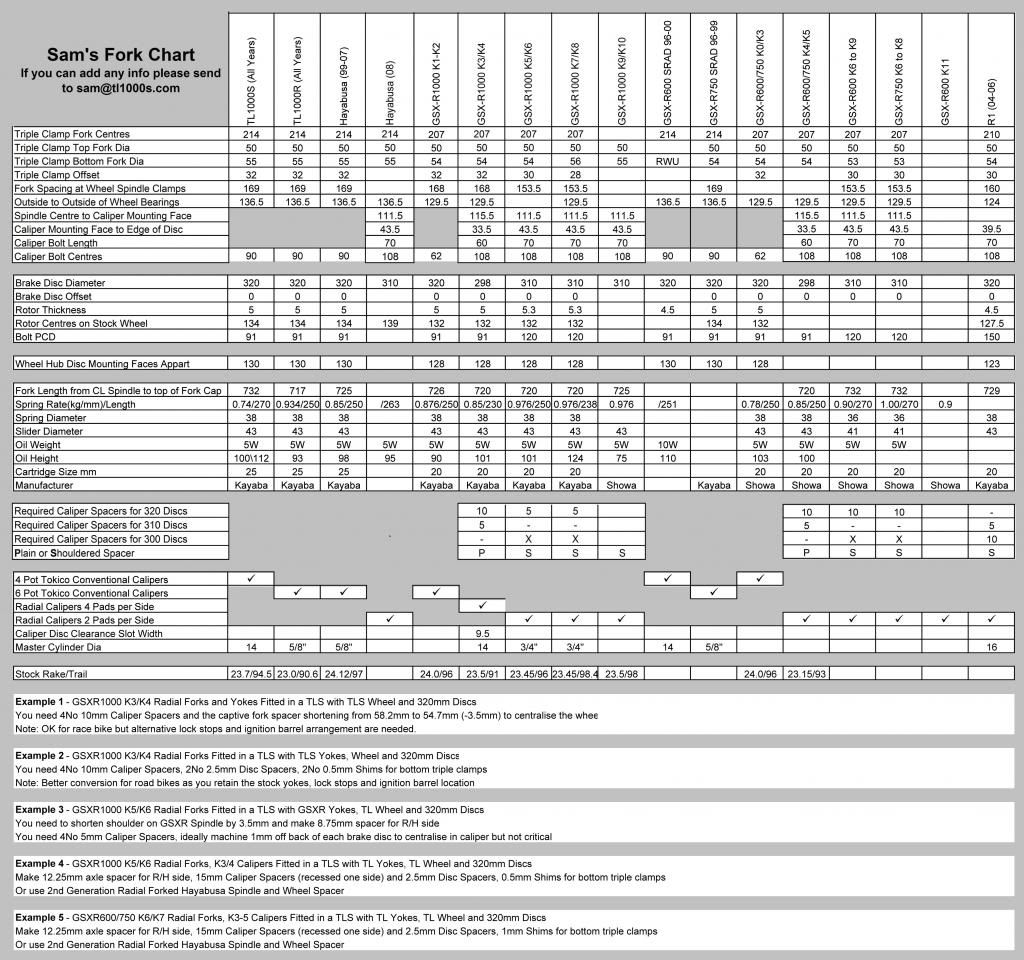

#5 PostAuthor: Ginger Bear » Sun Mar 03, 2013 11:57 am
This might help.......
I originally found this on the oldskoolperformance site, although the chart I have posted is an updated version.
More info here..... http://www.oldskoolperformance.com/foru ... =10&t=1659
# 104

#6 PostAuthor: Royalratch » Sun Mar 03, 2013 1:32 pm
Thanks dude.
No confirmation on 05/06 ZX6R fork diameters tho.
Maybe my digital calipers are not accurate? Doubt that tho...
