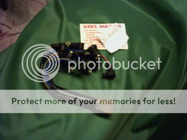

Friend of mine has a Z1r which he has owned since nearly new and he is having constant problems with the wiring. Does anyone know if a replica is available (like the Z1 ones)?

no not as yet simon i know some have had some made up from scratch
and depends on whats wrong ive got a spare he can have to make good if wanted and some of the connector blocks are available :wink:

Thank compo, I thought that was the case as I couldn't see any on the Z-power site (although that doesn't always mean anything). I think it has been repaired many times over the years and the connectors are all a bit brittle. He's coming down to Bristol soon so hopefully I'll catch up with him and find out a bit more about the issues. Thanks for the kind offer of your spare loom, I'll let you know if he needs it. Cheers.

I used to have quite regular wiring things happening with my Z1-R. I made a complete new one (several times) with all the wire & connectors from here:
http://www.vehicle-wiring-products.eu
All you need is the original one as a pattern and the colour diagram from the manual. I found it better to build the loom actually on the bike too.
The latest reincarnation of mine uses waterproof mini connectors.
Hope that is some help
H
H
Thanks Howie, that is an option although not as easy as buying a repro :wink:

Does Dave Ennis still recondition looms? he did mine a million years and 50,000 miles ago and it's still going strong, it was all horrible and scotchblocked and everything
