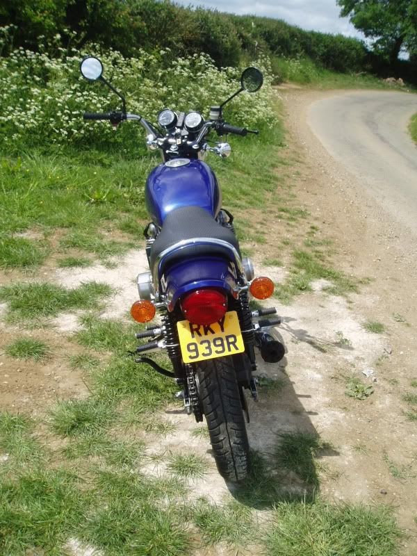

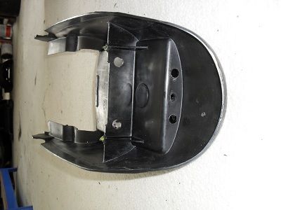

#6 PostAuthor: Mark Tiller » Sun Apr 22, 2012 7:52 pm
This is my A1 with Z1 tailpiece and tailtidy fitted showing the contour of the seat against the tail.
the rear tray from the A1 does not fit inside as previously stated
Another view when grabrail is on
