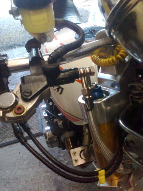

Shhhhhh, don't tell anyone....
very pritty - just one suggestion - now don't think I am getting at you it's just that I have your well being in mind
Move the hoses to route under the bottom yoke and then when you compress the forks the hoses shouldn't catch on anything or chafe against the cooler......
