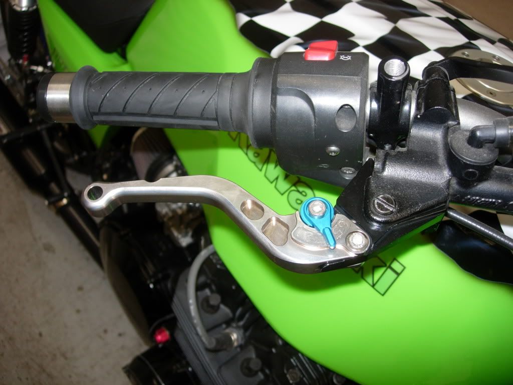

Thanks for the ideas Guys, have you got a pic of the levers Steve...rob
Ginger Bear
Posts: 6850
Joined: 16th Dec 2008
Location: In the Dark.
#7 PostAuthor: Ginger Bear » Thu Mar 15, 2012 11:29 am
Very similar to this, same shape, maybe slightly darker in colour.
If your half tempted Rob, I'll dig it all out & take some pic's.
