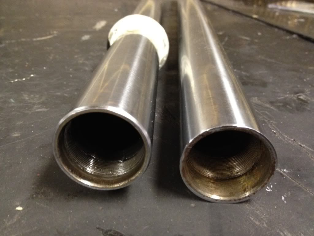

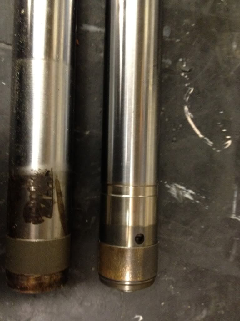

Hi i have just purchased from the ebay a set of nos z1000j 1 front fork stantions. Next to my old units there both the same length & diameter. But there are some differences. At the bottom of the stantions by the bush there is a machined groove about 5mm in diameter and a hole through the stantion bvetween the bush & groove which isn't on the new set. The thread in the new units are also set deeper within the stantion up to the old one's probably about 10mm. I was told my old forks were z1000j but what model who knows! I wondered if someone had any advice if these new stantions are useable for me. I know some newer parts superseed old ones etc...

Cant answer youre specific questions but you may find these pictures useful.
They're the forks out of my J1 and i believe them to be original but not certain.
http://s254.photobucket.com/albums/hh86 ... 1%20Forks/
Click any picture to enlarge it.
The missing hole probably wont do any harm as they dive very badly under heavy breaking and no holes may help a bit.
That said they are silky smooth for road riding just dont use the brakes
If you need a pair of lower bushes speak to Z Power and ask them for the GPZ dodge as J ones arn't listed but the GPZ ones can be adapted. They will know what you on about.
