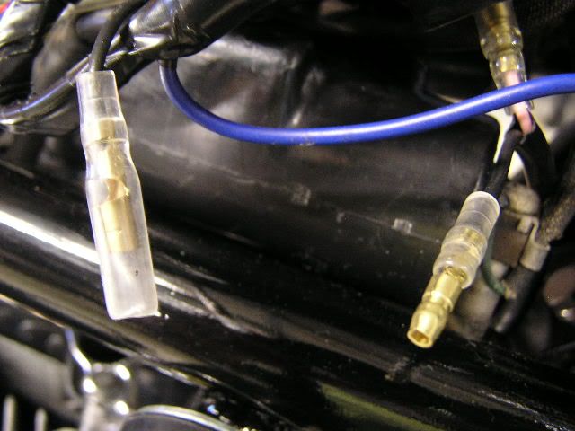

Those non-latching plug shells are also a direct replacement for the originals, and the little extra things like the black sleeve for the harnesses just make it all too easy in my opinion.
Z903
Posts: 434
Joined: 23rd Jan 2010
Location: North of the South Island - Australia
#21 PostAuthor: Z903 » Wed Feb 08, 2012 8:00 am
Gawd! Why is this site so slow?
Had to work last night, so no Banana's.

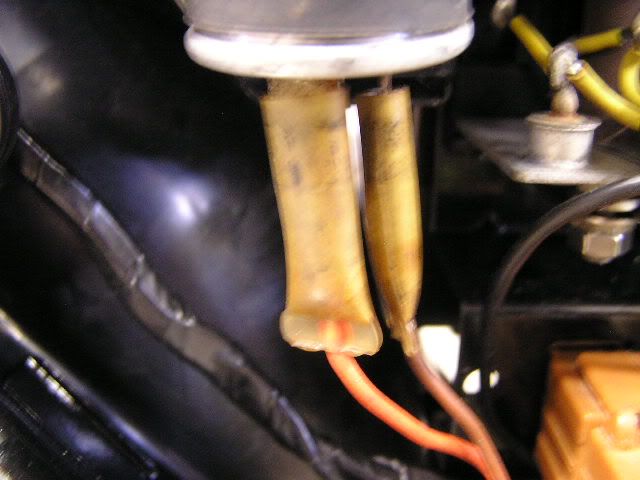

First 2 pics are how they turn out
This is an original insulator of course. But I don't think it'd be easy to melt the ends flat as the factory did? Then again maybe something as simple as a hot pair of pliers or the like may do it?
