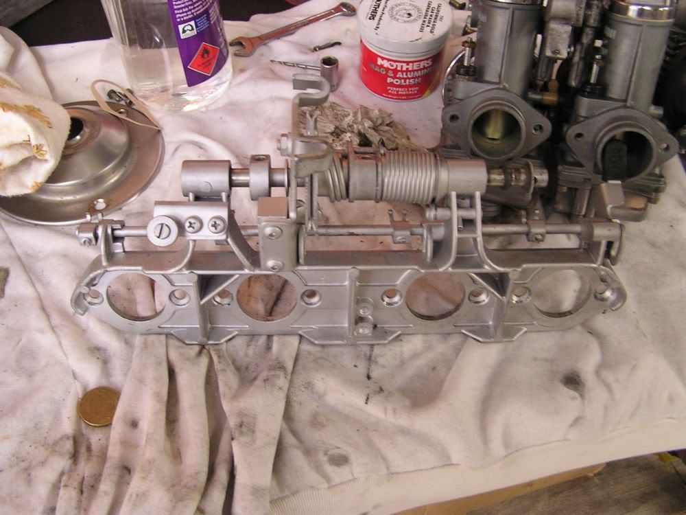

#4 PostAuthor: Z903 » Mon Jan 02, 2012 10:34 pm
Oh! does that apply to the early carbs as well?
I'm just in the process of cleaning up a set I've bought, and this is how the holder plate came off.....claws up.
So this is arse about then?
For what it's worth the parts book shows them claws up?

#5 PostAuthor: zed1015 » Mon Jan 02, 2012 10:51 pm
Yours look correct.
The early ones are fork ends up but they have curled over ends (pointing down) for smooth operation.
Should have worded my previous reply more clearly :roll: .

#6 PostAuthor: Z903 » Mon Jan 02, 2012 11:05 pm
Yes, I see!
thanks...it had me worried there for a moment.:shock:
