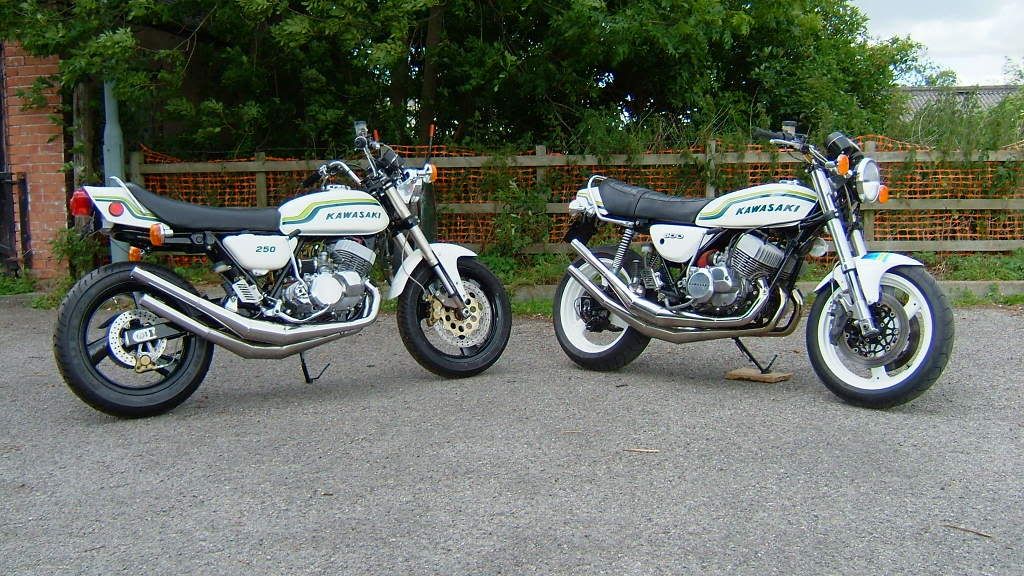

The zxr forks are certainly a common mod on all typres of special.Another front end to consider is from an rgv250.
On the right is a kh250 with an rgv250 front and rear end and H1 500 engine.
The bike on the left is a kh250 with h1 engine.The front and rear end are from a cagiva!!!
The point i am making is you can make owt fit owt..Sorry...thats not much help is it? :oops:

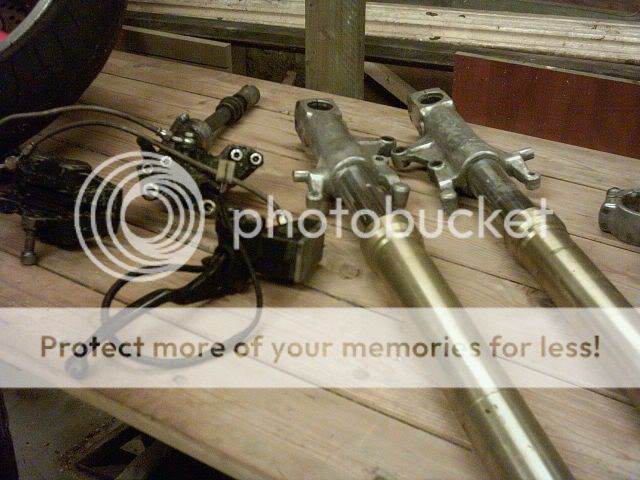

paul not a problem u need the 43mm top and bott yoke's and modd the stem to fit as this pics,
these have been made to fit all zeds from 750-up. :wink:
