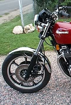

#5 PostAuthor: Iain marshall » Thu May 14, 2009 5:35 pm
As Paul says the mudguards are different,the ST has a leading axle which causes the guard to sit further forward and if i remember right the space between the forks is wider on the ST.Hope this is of some help

#7 PostAuthor: Iain marshall » Thu May 14, 2009 5:45 pm
John thats the problem, they do the similar.One the MKII the mounting holes are symetrical ie the mudguard could be fitted either way round.On the ST the mounting holes are further back due to the axle being at the front of the fork leg.
