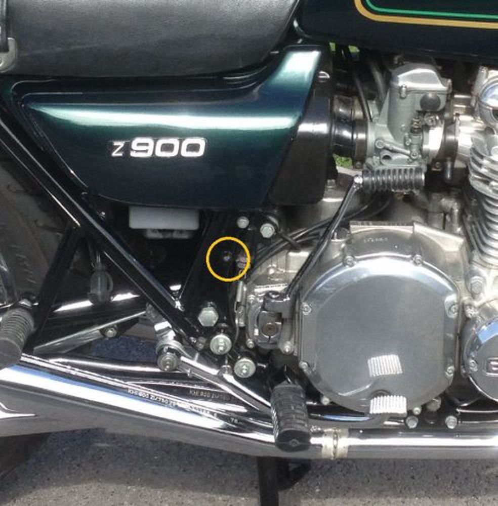

Got my bike serviced at garage and just noticed that my tax disk and the no 7 bolt (not sure what it is called, or how important?) to which it was attached is missing.
The garage when i picked up from it service had a flat battery. When they replaced the battery they took the bolt off to get tax disk out of the way, but when i went to pay did not check on my return - hopped on bike an away I went. Just noticed missing, garage looking next week but I bet they don't find the disk or bolt.
Anyone have a replacement bolt, or know part description so I can find elsewhere?

Engine mounting bolt - #7 - 8mm thread / 12mm head / 52mm long.

bolt part no 92001-1578 but it is superseded & will have a different head on it
