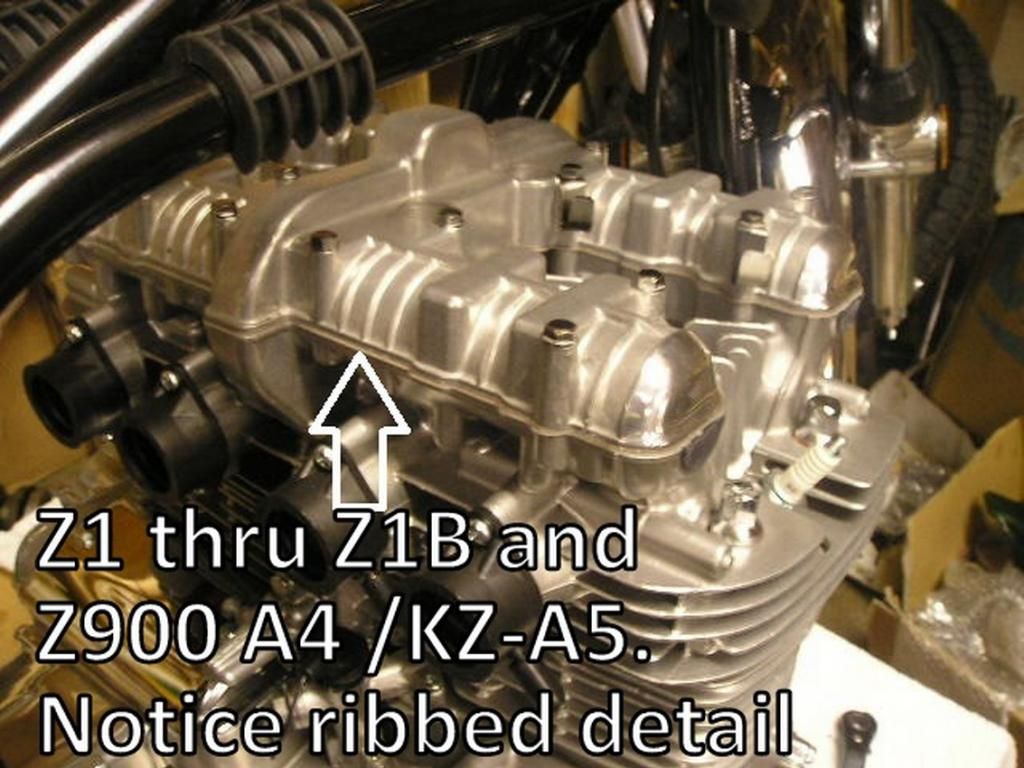

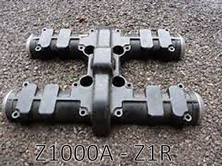

Zed cam covers after the Z900 A4 are different.
See pics below...

#3 PostAuthor: Jay1969 » Sun May 18, 2014 9:16 pm
When sold on eBay, seller's don't tend to show the shaft end half-moon
detail, but another way of identifying the difference is that Z1000 - Z1R
don't have ribbed edges...
