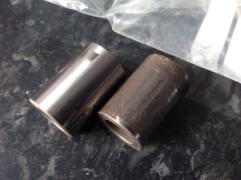

I'm looking for a set of good bushes that go inside the needle rollers on the swinging spindle of my '83 GPZ1100A1 uni
They look like this when they're fucked :evil:
From memory I think the ID is 15mm OD is 25 and length 37 . I'd spin some up on the lathe but they're hardened and ground :(

Mine were similarly shot, tried every where no longer available from Kawasaki, got them made in stainless steel and bought needle rollers from simplybearings.co.uk with genuine seals (still available) works a treat. The dimensions are on the cmnsl website

if these are what the bearing runs on they need to have a hardened surface I doubt stainless will last that long. HRC 58-64

Depends on how much lube and how few miles you do!

#5 PostAuthor: jonhunt » Mon Feb 10, 2014 9:14 am
You need lube but it won't help with the load. Yep if you dont ride it it will never break :lol:

I can easily spin some up in stainless, but as Jon rightly points out, they need to be hardened.

My reasoning is I will be lucky to do 1000 miles on it each year, if it wears out in that time I sort out another one. It's got a bolt running through it so I can't believe it will snap so the only issue is reduced lifespan. Seeing as Kawasaki probably had to over engineer them incase of neglect (which they all were - so finding a good second hand one is unlikely) a reduced spec item that keeps the bike on the road has to be a sensible option - doesn't it? Or am I risking a catastrophic suspension failure?
Either way, if you find a way of making some hardened steel items perhaps you could make me some too - I would need both smaller diameter spacers, the big one is in good shape.

Fork rechrome specialists will be able to sort them surely?

Luckily I have managed to source one from Cradley and one is OK so I'm sorted for the time being :)

by the way the technical term for f&*ked is false brunelling caused by small movements back & forth that removes the lube & wears the surface. Just being a smart arse
