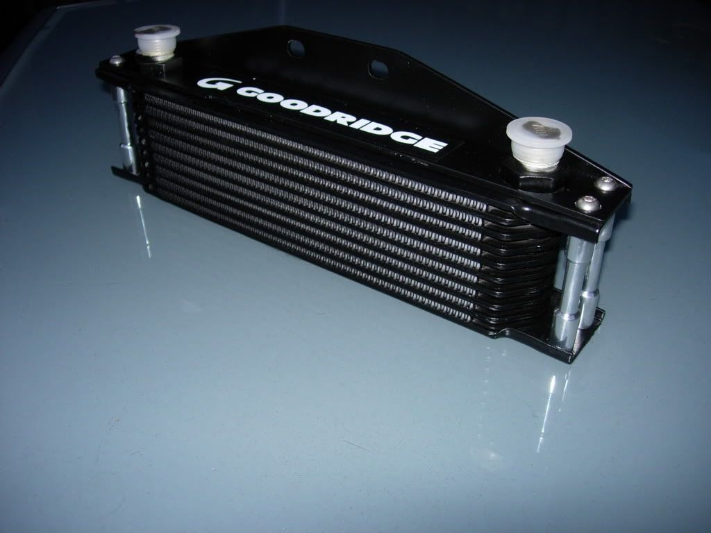

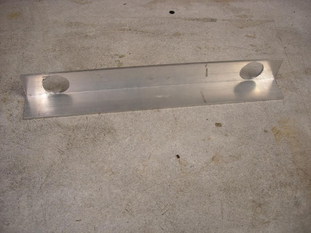

Chris, the cooler & lines on my 1170R came as a complete kit for a Renault Clio. I think most of these coolers are generic & just branded to suit.
This was a 'Mocal' and didn't take too much work to turn it into this;
There's something similar going cheap on ebay at the moment........
http://www.ebay.co.uk/itm/10-ROW-UNIVER ... 500wt_1361

#14 PostAuthor: zed1015 » Fri Jul 13, 2012 9:30 am
Here's the goodyear hose.
http://www.ebay.co.uk/itm/290603815088? ... 1497.l2649
and cooler fittings,
http://www.ebay.co.uk/itm/400308676804? ... 1497.l2649
You should be able to do the whole cooler set up for around £100 and a bit of fabricating.
This is the same cooler, pipe and fittings as i used on the Drouin.
