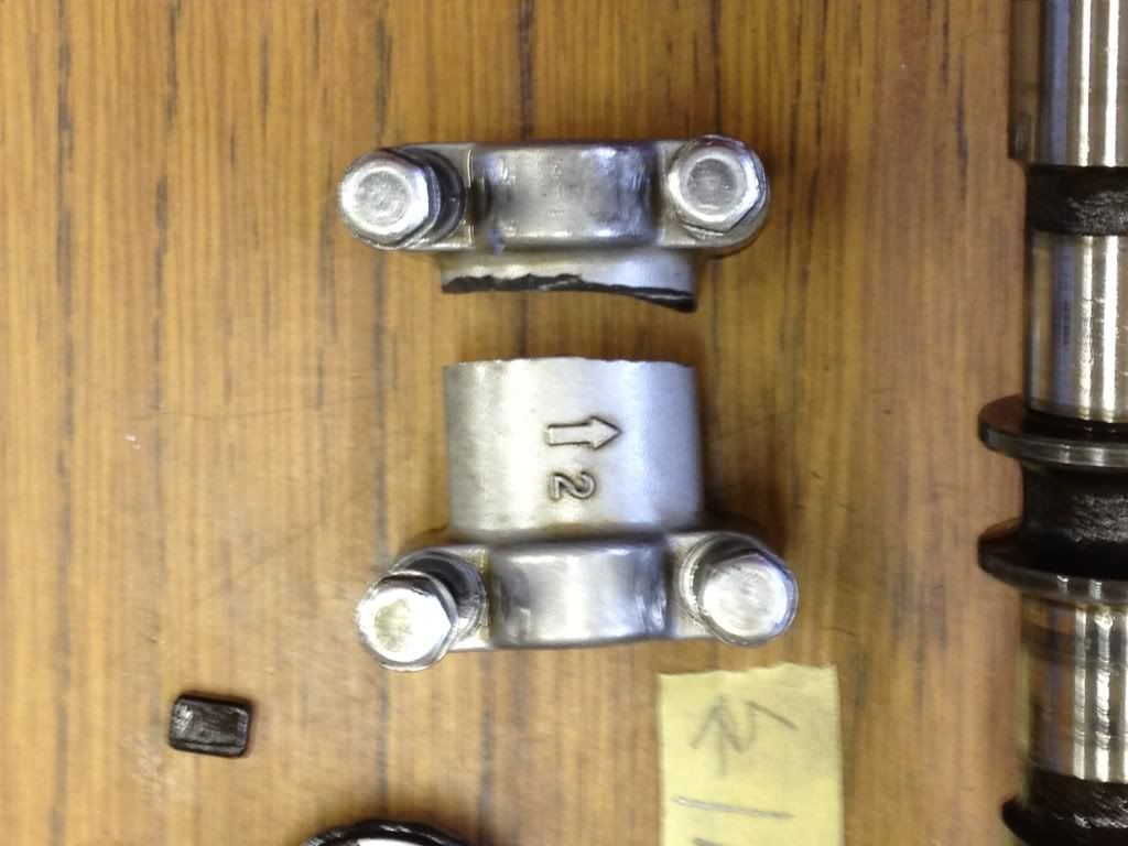

Hi Guys , anyone got a cam cap. Do I need the same one as the one that is buggered.

I think you are going to have to buy a few to try to match to your cam unless you are very lucky as these are machined for your cams , some may be too tight ! Think this is correct

You don't need another cap (see my reply in your original post)
Remove the broken bridge and use as two seperate caps (ala z650 etc).
Mark their original locations so they don't get mixed up.
Ideally fit a second dowel to each cap but not crucial.
They were only made in pairs for manufacturing simplicity.
