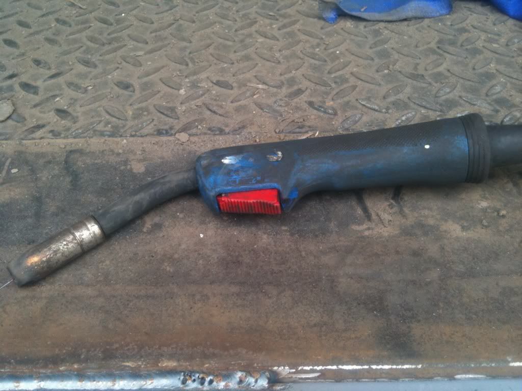

It is most important to have a Euro torch as these are easily replaced and available anywhere.

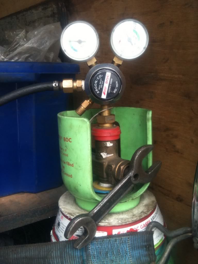

A decent regulator is also required.

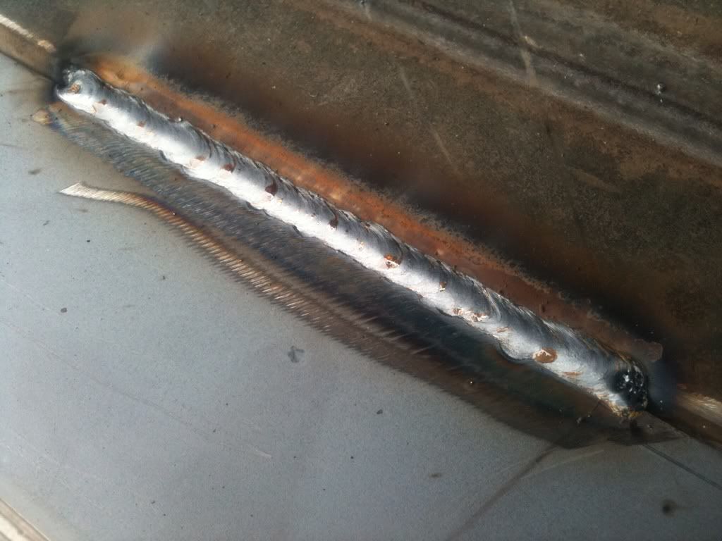

As Gez said, with a good gas flow it is quite easy to weld outside. Here is a weld I did outdoors and with a slight bit of rust under the job I was welding. It was not possible to completely remove the rust and the oxidisation as the job was heated caused gas bubbles.
You obviously know what you are doing when welding but all that has been said before applies. The highest continuous rating you can get for your budget will be best. Good luck.
