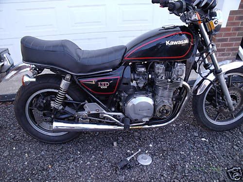

Yes no problem i will have a go at it tomorrow night and get back to you by the weekend got your no etc cheers mate there would be no rush for it if it was running now it would no be used till spring next year might run it for the mot but that would be all not used the pan euro since the Ace cafe reunion do last month http://i224.photobucket.com/albums/dd10 ... 000LTD.jpg
pic of the bike
