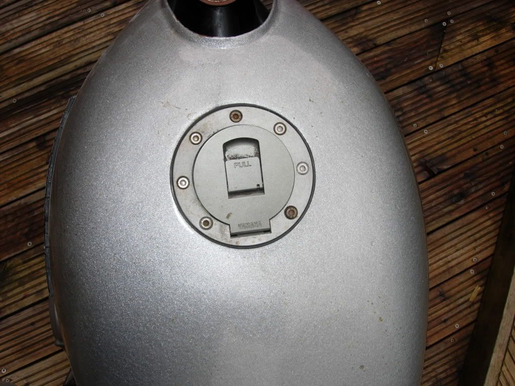

Using a donor filler is an excellent way of doing things & will have a breather built in. Here's a Yamaha filler fitted complete.

I would like a non locking one, one less key to lose. What size diameter was the one you used GB?, breather situation should'nt be a problem for the guy that will do this for me, he makes frames and tanks in ali and steel.

I used the smallest one they had (3.15" o.d.) so it would not overhang the edges of the raised centre section of the 'J' tank.
If I were fitting this type to a 'rounder' Z1000/650 style tank I would use one with a larger o.d.
