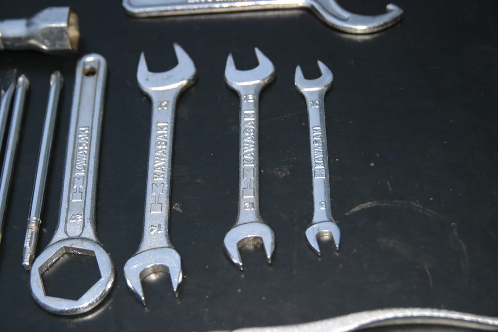

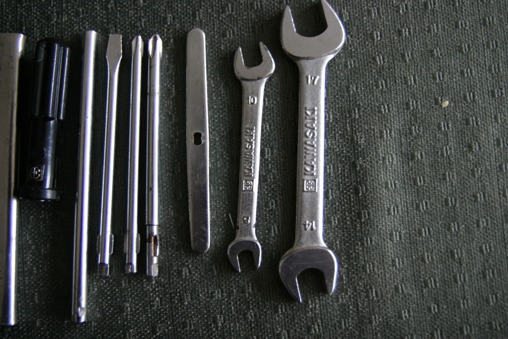

out of curiosity how can you guys tell the diff between an old z1 tool kit and something from from say a 1000j :oops:

Steve. These tools are from a Z1 series. Note the KHI logo preceeding the upper case font "KAWASAKI". Also note the Gold KHI on the screwdriver handle.
These are from a Z900 or Z1000A series where the logo has changed to the stylised "BIG K" but still upper case "KAWASAKI" The 8/10 spanner is from a Z1 though. I am still looking to swap mine for a correct 900/1000 tool.

OK thanks quick insight there , if only they had kept the same design would have saved a lot of hassle :)
