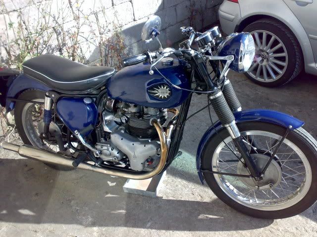

I bought this bike on Ebay last year unseen as a " project ". The seller seemed pretty straight and I got it at a good price or so I thought.
Then the fun started when I decided to have a ride on it and it handled realy badly. I found the cause to be a very loose back wheel :??
To cut a long story short I ended up replacing most of the engine and fitting a clutch that worked and putting right so many bodges that I lost count.
Four helicoils needed in the head ? A new clutch pushrod instead of an old piece of bar filed round ? Wrong number and type of clutch plates ? Wrong pistons ? Teeth broken on kickstart pinion ? Valves and guides shot and piston rings cracked meaning a rebore needed....big ends shot...speedo shot.......
Any way £1500+ and 100s of hours later this is the result. I have done about 200 miles on it now and it rides fantasic :D

Looks nice that Steve..is it an A7 shooting star?

kas750 wrote:Looks nice that Steve..is it an A7 shooting star?
Yes it is but the engine is now a 650 after fitting A10 barrels, crank and pistons. The alloy head and crankcases are still the original A7SS ones.
I have also fitted new primary drive and "upped" the gearing to suit the bigger capacity as it has quite a bit more torque now than when it was a 500. :D

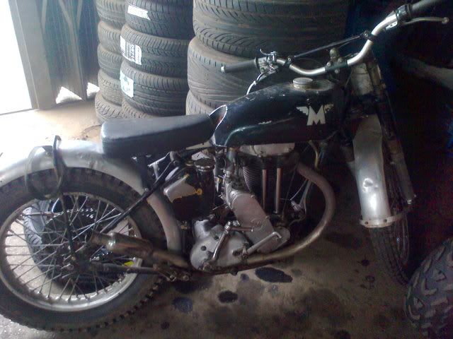

My mate at work has a few Beeza's...... a sweet B31 and an A7 (and 2 x A65's).... this A7 has been in his family for +30yrs
And this G3L....
